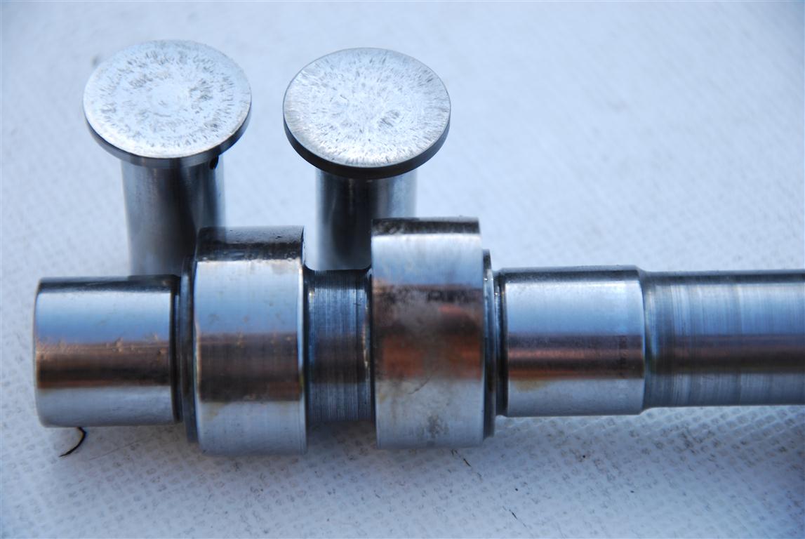

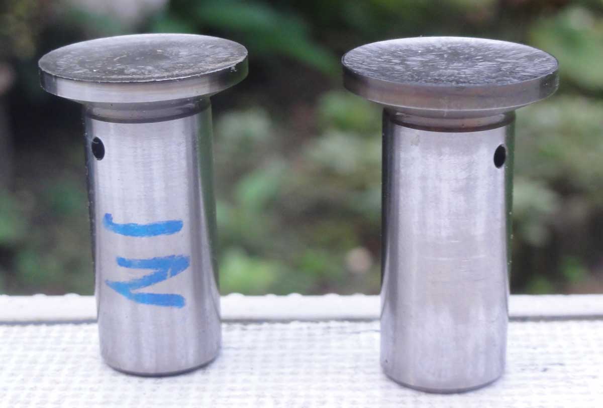

When back home from GMG the bike made to much noise from the heads. So I checked valve play. It should be 0.10/0,15mm, it was 1MM!!
So I took the top of, and what I found wasn't good, the picture tells the story. Bike is just 3 month out of warranty.
It was build in 2008, and bought new, with the 0km recall from tappets done. Had it's service at a dealer, and now 19.000km.
So now I'm going to replace the cams and tappets on both sides. With new parts. I will put the 2009/2011 cams in, with shims to reduce play. I can change and adjust the mapping myself, so no problem with that.

Commento file: concave tappet
DSC02146a.jpg [ 46.34 KiB | Osservato 2770 volte ]
Commento file: rough cam
DSC_3267 (Medium).JPG [ 104.19 KiB | Osservato 2771 volte ]
Commento file: Tappets
DSC_3266 (Medium).JPG [ 109.11 KiB | Osservato 2771 volte ]

The same problem at my bike build 2008, before 15000 km.

Quelli sembrano i bicchierini della primissima serie stelvio, oggetto di richiamo, sbaglio?

I'm sorry for the problem, but there is a kit to fix everything. I am sure that after everything will be ok.

Sagitter, My bike had the recall kit when it was new....
